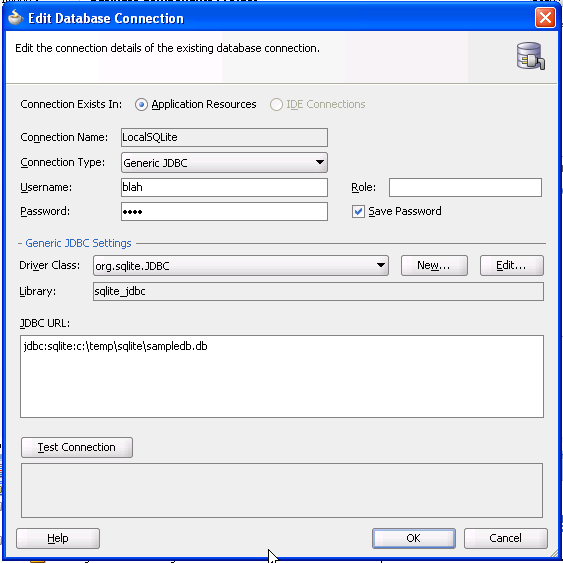

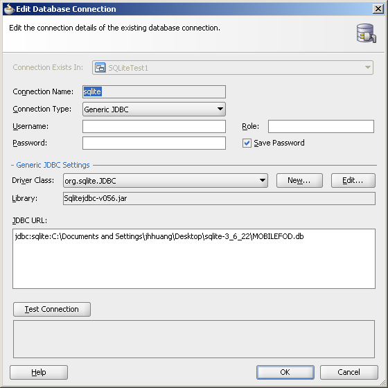

Try putting in dummy values for the username and password for the SQLite
connection. It seems that ADF BC doesn't like the notion of not having
database credentials.

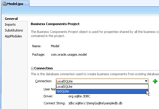

Note also that you can have multiple connections stored for the ADF BC
configuration, so you can easily swap connections without having to edit
the connection details each time:

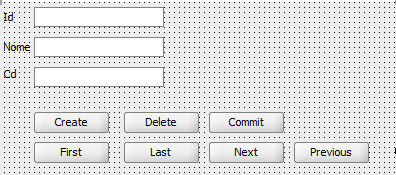

> 6. Create a Jpanel
> 7. Using the DataControl, drag-n-drop the 3 attributes into the jPanel.
> 8. Using the Datacontrol, drag-n-drop some operations into the JPanel
> (Create, Delete, Commit, First, Last, Next and Previous).

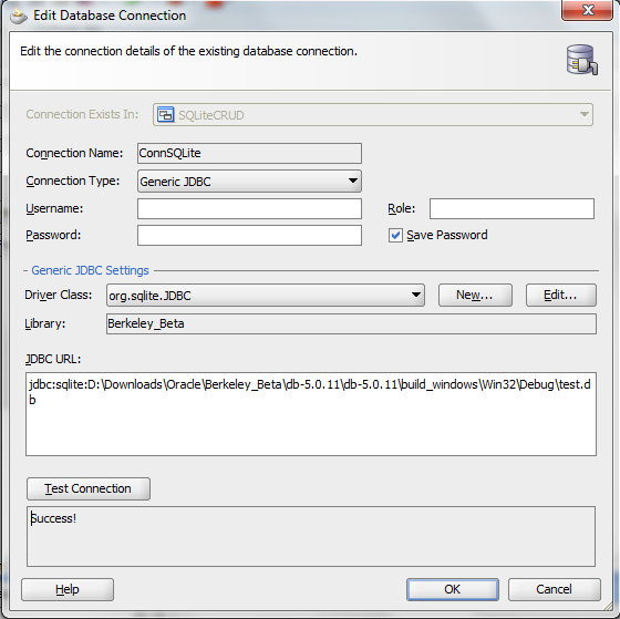

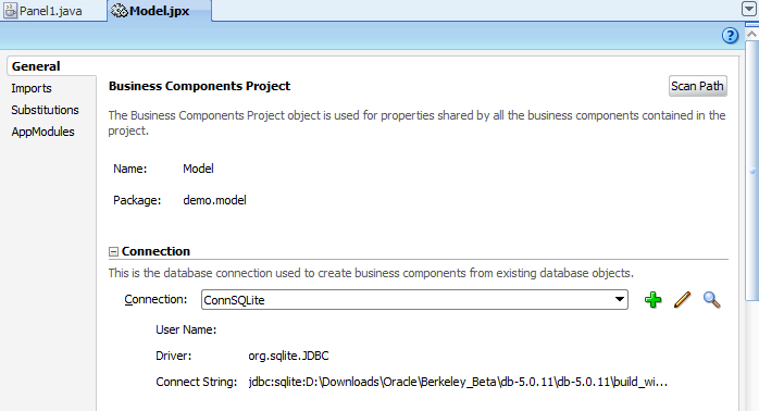

> 10. Create a Database connection for SQLite.
> 11. Edit the Model.jpx file to switch the connection to SQLite.
> 12. Run the Application

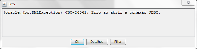

> At this point, I got an error related to the JDBC Connection.
>                 Translating the message: JBO-26061: Error opening the
> JDBC Connection.
>                 Clicking on the "Details" button I got:

>                 at demo.view.Panel1.main(Panel1.java:181)
>                 Could you please check, if I'm using the workaround as
> expected?
> Regards,
> Luis

> Great!
> Luis, we found a bug that prevents using the ADF BC wizards at design
> time directly against SQLite. We're working on addressing this (or at
> least finding a better workaround), but in the mean time, we would
> suggest that you create an identical database schema in an Oracle
> database, and develop against that. As described in the "developing
> for multiple databases" how to, use the SQL92 SQL flavor and Java type
> mappings. You can then switch the connection definition to test
> running against SQLite. If we get a better workaround, we will keep
> you posted.
> -- Brian
> On 3/19/2010 3:56 AM, Luis Paolini wrote:
> Joe,
> Thanks for the information. I got Zentus JDBC driver and followed the
> steps.
>                 It worked as expected and I could connect to my SQLite
> test database.
> Regards,

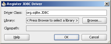

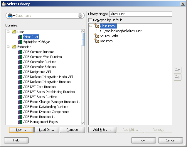

> Sure - a couple of steps.  First, you will need to download a JDBC
> driver that can connect to a SQLite database.  We had tested against
> Zentus driver, which is an open source driver that you can download
> from Zentus.  I downloaded the driver and had installed to a directory
> called c:\zentus.  This should give me a file sqlitejdbc-v0xx.jar in
> c:\zentus, where xx is the exact version number you download.
> To connect to SQLite DB, I would first create a new database
> connection in JDeveloper, and then configure the connection as follows
> -- please reference the screen shot below:
> 1.    First in the Connection Type drop down, select Generic JDBC.
> Click "New" next to the driver class drop down, and type
> org.sqlite.JDBC in the name of the driver class.
> 2.    Click browse, and then click New in the dialog box below:
> 3.    Click Add Entry in the dialog box below, and then select the
> sqlitejdbc-v0xx.jar on your file system.  After you select the jar
> file, you should see this jar added to the class path.
> 4.    Click OK and then OK to return to the DB Connection creation
> screen.
> 5.    In the JDBC URL window, type this jdbc:sqlite:<Path to your
> SQLite/BDB data file>.  For example, jdbc:sqlite:C:\Documents and
> Settings\jhhuang\Desktop\sqlite-3_6_22\MOBILEFOD.db, where
> MOBILEFOD.db is the SQLite file containing my data.
> 6.     Leave user name/password blank.  SQLite connection does not
> need ID/password.
> 7.    Click "Test Connection"  If this is configured correctly, this
> should succeed.
> Thanks,
