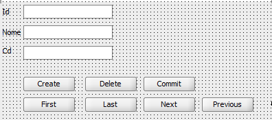

6.       Create a Jpanel
7.       Using the DataControl, drag-n-drop the 3 attributes into the
jPanel.
8.       Using the Datacontrol, drag-n-drop some operations into the JPanel
(Create, Delete, Commit, First, Last, Next and Previous).

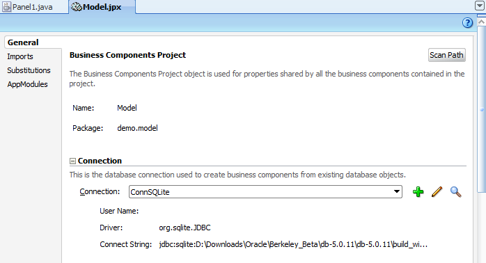

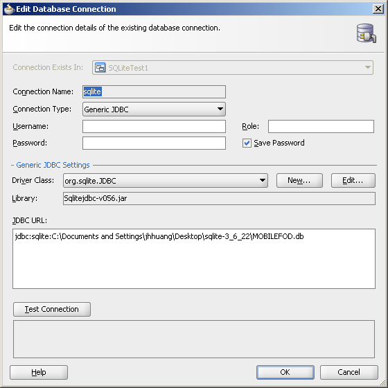

10.   Create a Database connection for SQLite.
11.   Edit the Model.jpx file to switch the connection to SQLite.

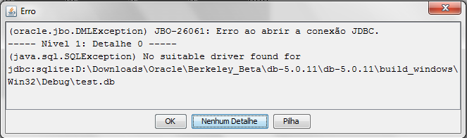

12.   Run the Application
At this point, I got an error related to the JDBC Connection.
                Translating the message: JBO-26061: Error opening the JDBC
Connection.
                Clicking on the “Details” button I got:
                This is the JDev logfile:
                Exception in thread "main" oracle.jbo.DMLException:
JBO-26061: Erro ao abrir a conexão JDBC.

Caused by: java.sql.SQLException: No suitable driver found for
jdbc:sqlite:D:\Downloads\Oracle\Berkeley_Beta\db-5.0.11\db-5.0.11\build_wind
ows\Win32\Debug\test.db

Sure - a couple of steps.  First, you will need to download a JDBC driver
that can connect to a SQLite database.  We had tested against Zentus driver,
which is an open source driver that you can download from Zentus.  I
downloaded the driver and had installed to a directory called c:\zentus.
This should give me a file sqlitejdbc-v0xx.jar in c:\zentus, where xx is the
exact version number you download.
To connect to SQLite DB, I would first create a new database connection in
JDeveloper, and then configure the connection as follows – please reference
the screen shot below:

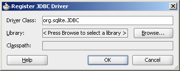

1.    First in the Connection Type drop down, select Generic JDBC.  Click
“New” next to the driver class drop down, and type org.sqlite.JDBC in the
name of the driver class.

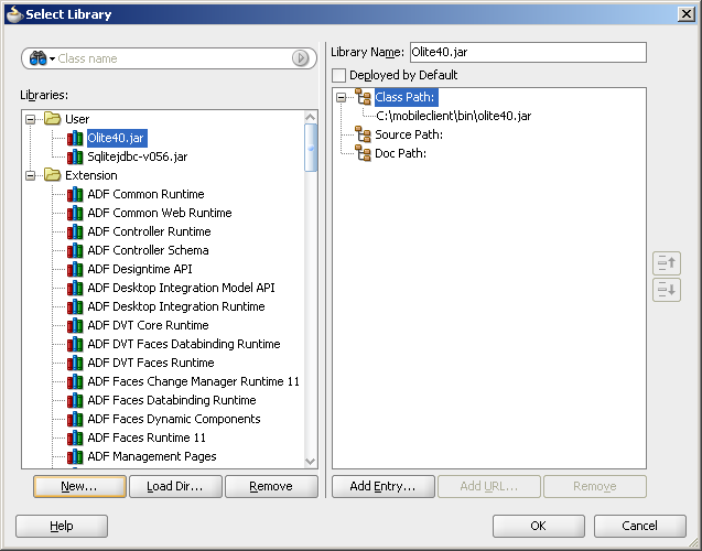

2.    Click browse, and then click New in the dialog box below:
3.    Click Add Entry in the dialog box below, and then select the
sqlitejdbc-v0xx.jar on your file system.  After you select the jar file, you
should see this jar added to the class path.
4.    Click OK and then OK to return to the DB Connection creation screen.
5.    In the JDBC URL window, type this jdbc:sqlite:<Path to your SQLite/BDB
data file>.  For example, jdbc:sqlite:C:\Documents and
Settings\jhhuang\Desktop\sqlite-3_6_22\MOBILEFOD.db, where MOBILEFOD.db is
the SQLite file containing my data.
6.     Leave user name/password blank.  SQLite connection does not need
ID/password.
7.    Click “Test Connection”  If this is configured correctly, this should
succeed.

> Luis Paolini wrote:
>> Hi Brian,
>> Thanks for the document which describes some gotchas working with
>> non-Oracle databases and ADF Business components.
>> I still had no luck connecting to SQLite using JDBC driver from a
>> JDeveloper Application.
>> I tried to create a database connection using two different approaches.
>> The first one, using Database Navigator, as described in the document
>> you sent to me.
>> The Second one, I just create a POJO to connect to SQLite.
>> public Connection getConnection(){
>> Connection conn = null;
>> SQLite.Database db = null;
>> try {
>> Class.forName("SQLite.JDBCDriver").newInstance();
>> conn =
(Connection)DriverManager.getConnection("jdbc:sqlite:/D:/Downloads/Oracle/Be
rkeley_Beta/db-5.0.11/db-5.0.11/build_windows/Win32/Debug/test.db");
>> java.lang.reflect.Method m =
>> conn.getClass().getMethod("getSQLiteDatabase", null);
>> db = (SQLite.Database) m.invoke(conn, null);
>> } catch (Exception e) {
>> e.printStackTrace();
>> return conn;
>> Error Message:
>> Unable to load sqlite_jni: java.lang.UnsatisfiedLinkError:
D:\Downloads\Oracle\Berkeley_Beta\db-5.0.11\db-5.0.11\build_windows\Win32\De
bug\sqlite_jni.dll:
>> Can't find dependent libraries
>> Before running both cases, I did two configurations on JDeveloper.
>> 1. Added the library sqlite.jar in the classpath
>> 2. Added the parameter
-Djava.library.path=D:\Downloads\Oracle\Berkeley_Beta\db-5.0.11\db-5.0.11\bu
ild_windows\Win32\Debug
>> in the Launch Setting (Java Options).
>> I’m running JDeveloper 11.1.1.2.0
