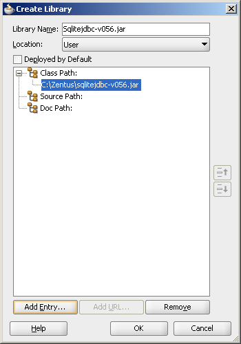

Hi Brian,

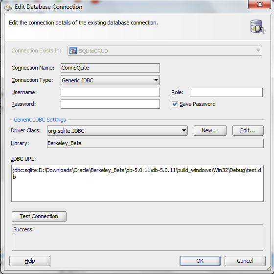

       I tried to put in dummy values for the username and password for the
SQLite connection. The connection test keeps returning “Success”,
but when I try to run the application using the SQLite connection, I still
get the same errors reported in my last email.
       The test you did just tried to validate the SQLite connection or you
had success running a simple application that uses ADF BC ?
Regards,
Luis

Luis --
I apologize for taking so long to respond. It took me a while to clear some
time in my schedule to try this out.

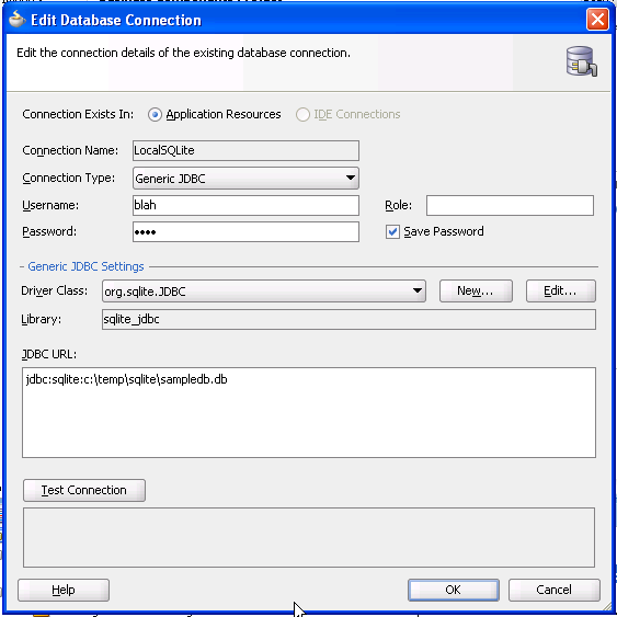

Try putting in dummy values for the username and password for the SQLite
connection. It seems that ADF BC doesn't like the notion of not having
database credentials.

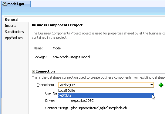

Note also that you can have multiple connections stored for the ADF BC
configuration, so you can easily swap connections without having to edit the
connection details each time:
-- Brian

3.       Using JDeveloper, create a new ADF Java Desktop Application
4.       Create a Database connection for Oracle XE database:
5.       Using ADF BC Wizard, create an Entity Object and a View Object
(updatable).

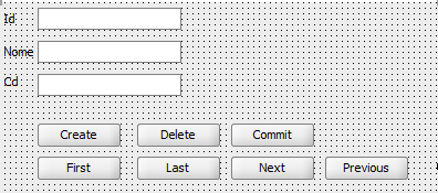

6.       Create a Jpanel
7.       Using the DataControl, drag-n-drop the 3 attributes into the
jPanel.
8.       Using the Datacontrol, drag-n-drop some operations into the JPanel
(Create, Delete, Commit, First, Last, Next and Previous).
9.       Run the application to check if everything is working.

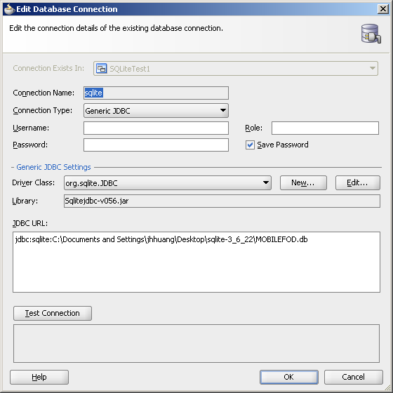

10.   Create a Database connection for SQLite.
11.   Edit the Model.jpx file to switch the connection to SQLite.
12.   Run the Application

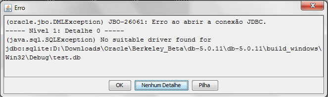

At this point, I got an error related to the JDBC Connection.
                Translating the message: JBO-26061: Error opening the JDBC
Connection.
                Clicking on the “Details” button I got:
                This is the JDev logfile:
                Exception in thread "main" oracle.jbo.DMLException:
JBO-26061: Erro ao abrir a conexão JDBC.

Caused by: java.sql.SQLException: No suitable driver found for
jdbc:sqlite:D:\Downloads\Oracle\Berkeley_Beta\db-5.0.11\db-5.0.11\build_wind
ows\Win32\Debug\test.db

Luis, we found a bug that prevents using the ADF BC wizards at design time
directly against SQLite. We're working on addressing this (or at least
finding a better workaround), but in the mean time, we would suggest that
you create an identical database schema in an Oracle database, and develop
against that. As described in the "developing for multiple databases" how
to, use the SQL92 SQL flavor and Java type mappings. You can then switch the
connection definition to test running against SQLite. If we get a better
workaround, we will keep you posted.
-- Brian

Sure - a couple of steps.  First, you will need to download a JDBC driver
that can connect to a SQLite database.  We had tested against Zentus driver,
which is an open source driver that you can download from Zentus.  I
downloaded the driver and had installed to a directory called c:\zentus.
This should give me a file sqlitejdbc-v0xx.jar in c:\zentus, where xx is the
exact version number you download.
To connect to SQLite DB, I would first create a new database connection in
JDeveloper, and then configure the connection as follows – please reference
the screen shot below:
1.    First in the Connection Type drop down, select Generic JDBC.  Click
“New” next to the driver class drop down, and type org.sqlite.JDBC in the
name of the driver class.
2.    Click browse, and then click New in the dialog box below:
3.    Click Add Entry in the dialog box below, and then select the
sqlitejdbc-v0xx.jar on your file system.  After you select the jar file, you
should see this jar added to the class path.
4.    Click OK and then OK to return to the DB Connection creation screen.
5.    In the JDBC URL window, type this jdbc:sqlite:<Path to your SQLite/BDB
data file>.  For example, jdbc:sqlite:C:\Documents and
Settings\jhhuang\Desktop\sqlite-3_6_22\MOBILEFOD.db, where MOBILEFOD.db is
the SQLite file containing my data.
6.     Leave user name/password blank.  SQLite connection does not need
ID/password.
7.    Click “Test Connection”  If this is configured correctly, this should
succeed.
