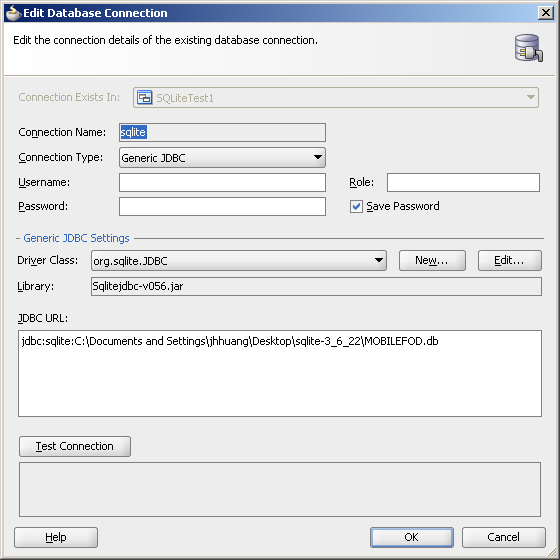

To connect to SQLite DB, I would first create a new database connection in
JDeveloper, and then configure the connection as follows – please reference
the screen shot below:

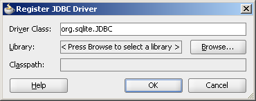

1.    First in the Connection Type drop down, select Generic JDBC.  Click
“New” next to the driver class drop down, and type org.sqlite.JDBC in the
name of the driver class.

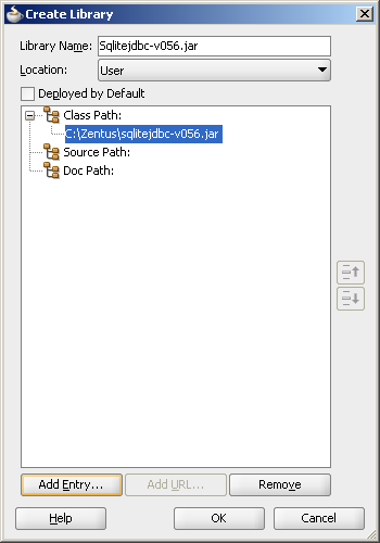

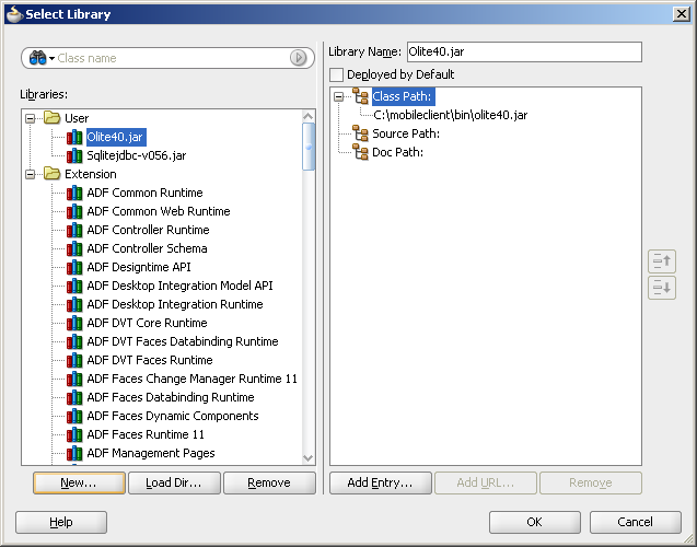

2.    Click browse, and then click New in the dialog box below:
3.    Click Add Entry in the dialog box below, and then select the
sqlitejdbc-v0xx.jar on your file system.  After you select the jar file, you
should see this jar added to the class path.
4.    Click OK and then OK to return to the DB Connection creation screen.
5.    In the JDBC URL window, type this jdbc:sqlite:<Path to your SQLite/BDB
data file>.  For example, jdbc:sqlite:C:\Documents and
Settings\jhhuang\Desktop\sqlite-3_6_22\MOBILEFOD.db, where MOBILEFOD.db is
the SQLite file containing my data.
6.     Leave user name/password blank.  SQLite connection does not need
ID/password.
7.    Click “Test Connection”  If this is configured correctly, this should
succeed.
