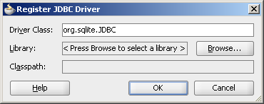

1.    First in the Connection Type drop down, select Generic JDBC.  Click "New" next to the driver class drop down, and type org.sqlite.JDBC in the name of the driver class.
2.    Click browse, and then click New in the dialog box below:

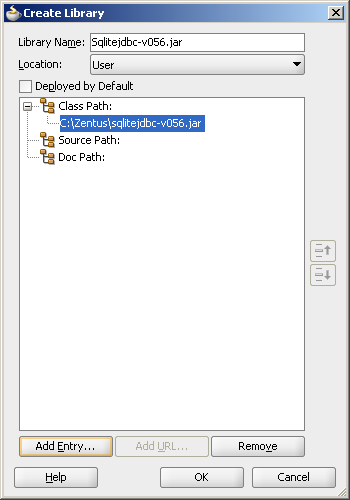

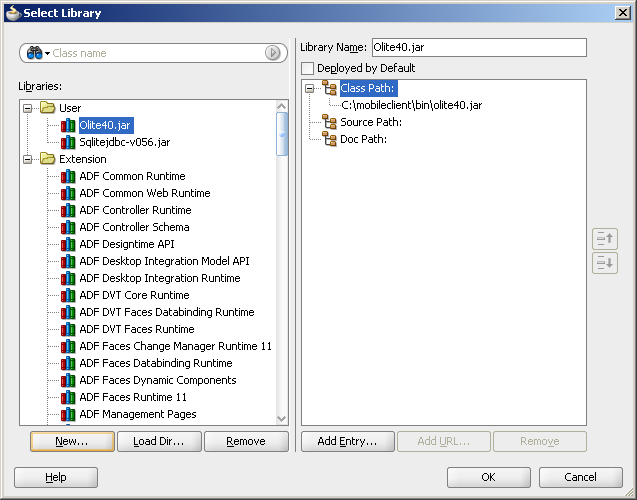

3.    Click Add Entry in the dialog box below, and then select the sqlitejdbc-v0xx.jar on your file system.  After you select the jar file, you should see this jar added to the class path.
4.    Click OK and then OK to return to the DB Connection creation screen.

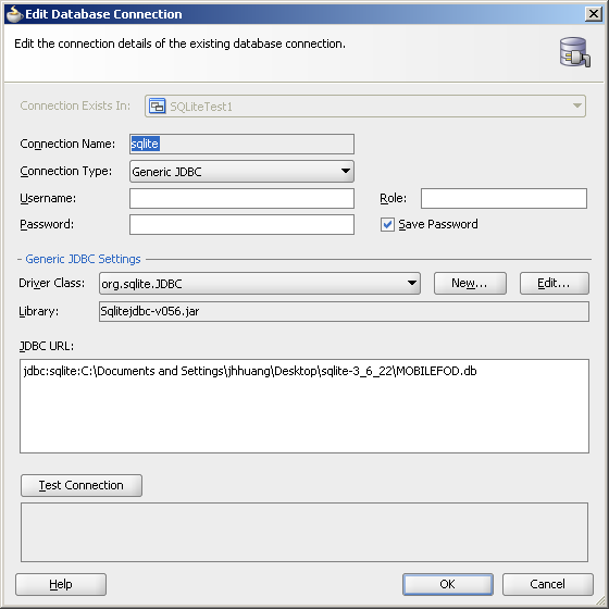

5.    In the JDBC URL window, type this jdbc:sqlite:<Path to your SQLite/BDB data file>.  For example, jdbc:sqlite:C:\Documents and Settings\jhhuang\Desktop\sqlite-3_6_22\MOBILEFOD.db, where MOBILEFOD.db is the SQLite file containing my data.
6.     Leave user name/password blank.  SQLite connection does not need ID/password.
7.    Click "Test Connection"  If this is configured correctly, this should succeed.
