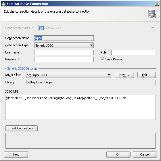

> To connect to SQLite DB, I would first create a new database
> connection in JDeveloper, and then configure the connection as follows
> -- please reference the screen shot below:

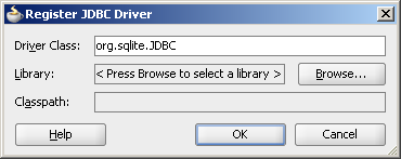

> 1. First in the Connection Type drop down, select Generic JDBC.  Click
> "New" next to the driver class drop down, and type org.sqlite.JDBC in
> the name of the driver class.

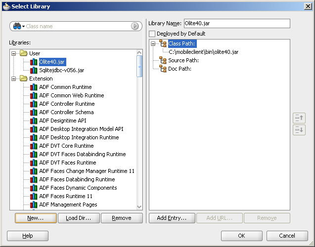

> 2. Click browse, and then click New in the dialog box below:
> 3. Click Add Entry in the dialog box below, and then select the
> sqlitejdbc-v0xx.jar on your file system.  After you select the jar
> file, you should see this jar added to the class path.
> 4. Click OK and then OK to return to the DB Connection creation screen.
> 5. In the JDBC URL window, type this jdbc:sqlite:<Path to your
> SQLite/BDB data file>.  For example, jdbc:sqlite:C:\Documents and
> Settings\jhhuang\Desktop\sqlite-3_6_22\MOBILEFOD.db, where
> MOBILEFOD.db is the SQLite file containing my data.
> 6.  Leave user name/password blank.  SQLite connection does not need
> ID/password.
> 7. Click "Test Connection"  If this is configured correctly, this
> should succeed.
