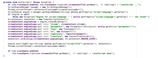

I’m trying now to wire that into my code but I’m not sure how to put that resulting “Context” into the right place to take effect.
This is my code to start the scripting engine (currently Nashorn based):
Can you tell me where to set the context here?

Hi Andreas,
there is now a solution to your problem. You can use "Target type mapping" [1] to specify you want that custom conversion in your code.
Find below some pseudo-code how to do that. You will want to fine-tune that to your usecase (not use allowAllAccess; not use HostAccess.ALL; maybe include additional types). A more lengthy discussion you will find in https://urldefense.com/v3/__https://github.com/graalvm/graaljs/issues/94__;!!GqivPVa7Brio!Pgc0pm15UXxeRsrjCp2Xr2PzWFlWlnyxs0yYGR3h2FFp0DeE7cwmwVMxz11rRpA5KcK6TQ$ . I'll also add an example of this to our FAQ in https://urldefense.com/v3/__https://github.com/graalvm/graaljs/blob/master/docs/user/FAQ.md__;!!GqivPVa7Brio!Pgc0pm15UXxeRsrjCp2Xr2PzWFlWlnyxs0yYGR3h2FFp0DeE7cwmwVMxz11rRpBtdiJ0gQ$  and/or our NashornMigrationGuide.md.
Best,
Christian
[1] https://urldefense.com/v3/__https://www.graalvm.org/sdk/javadoc/org/graalvm/polyglot/HostAccess.Builder.html*targetTypeMapping-java.lang.Class-java.lang.Class-java.util.function.Predicate-java.util.function.Function-__;Iw!!GqivPVa7Brio!Pgc0pm15UXxeRsrjCp2Xr2PzWFlWlnyxs0yYGR3h2FFp0DeE7cwmwVMxz11rRpB5UJ5vyw$
Context context = Context.newBuilder("js").allowAllAccess(true).allowHostAccess(getHostAccess()).build();
    private HostAccess getHostAccess() {
        HostAccess.Builder builder = HostAccess.newBuilder(HostAccess.ALL);
        builder.targetTypeMapping(String.class, Integer.class, null, (v) -> parseInt(v));
        return builder.build();
    private int parseInt(String input) {
        try {
            return Integer.parseInt(input);
        } catch (Exception ex) {
            return 0; //TODO should not fail silently
