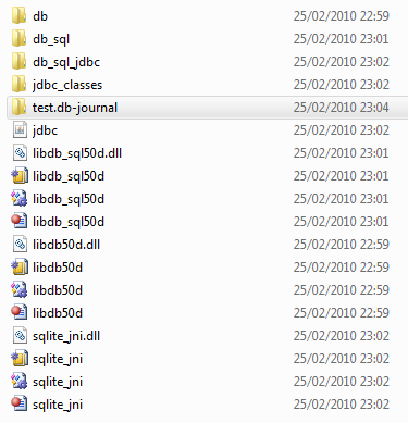

Hi George,
                I followed your instructions and had success building the db
library, db_sql and db_sql_jdbc projects, but when I executed
the command for test in build_windows/Win32/Debug I got a SQLITE prompt and
the test.db-journal directory was created but it is empty.
                Should I execute any command on SQLITE prompt?
                See below the files created in build_windows\Win32\Debug
directory.
Regards,
Luis

Luis,
Sandra is out today so I'll help.
I just tried what was sent to you for instructions and they worked, with
some modifications:
1.  I added the db_sql_jdbc project and changed the Linker->General->Output
File to $(OutDir)/sqlite_jni.dll
For good measure I also changed
Linker->Debugging->Generate Program Database File
and
Linker->Advanced->Import Library
similarly to add "sqlite_jni"
I don't think these are necessary but I did them.
2.  I had to build the db library first in the solution (project "db").  At
this time
the db_sql project depends on this so it's necessary.  This step may have
been missing
from your instructions.
3.  I then built the db_sql project
4.  I then built the db_sql_jdbc project
5.  The command for testing is, in build_windows/Win32/Debug (or Release if
you built that):
            java -classpath jdbc.jar -Djava.library.path=. SQlite.Shell
test.db
That worked.  The test.db and test.db-journal were populated correctly.
 I happen to be using Visual Studio 2008 Express on Windows 7 but if
anything
VS2005 will be smoother since there are no project file conversions
required.
If you start over you should start with a clean directory.  Also make sure
that your
PATH does not accidentally point to any old DB- or SQLite-related dlls.
Regards,
George
